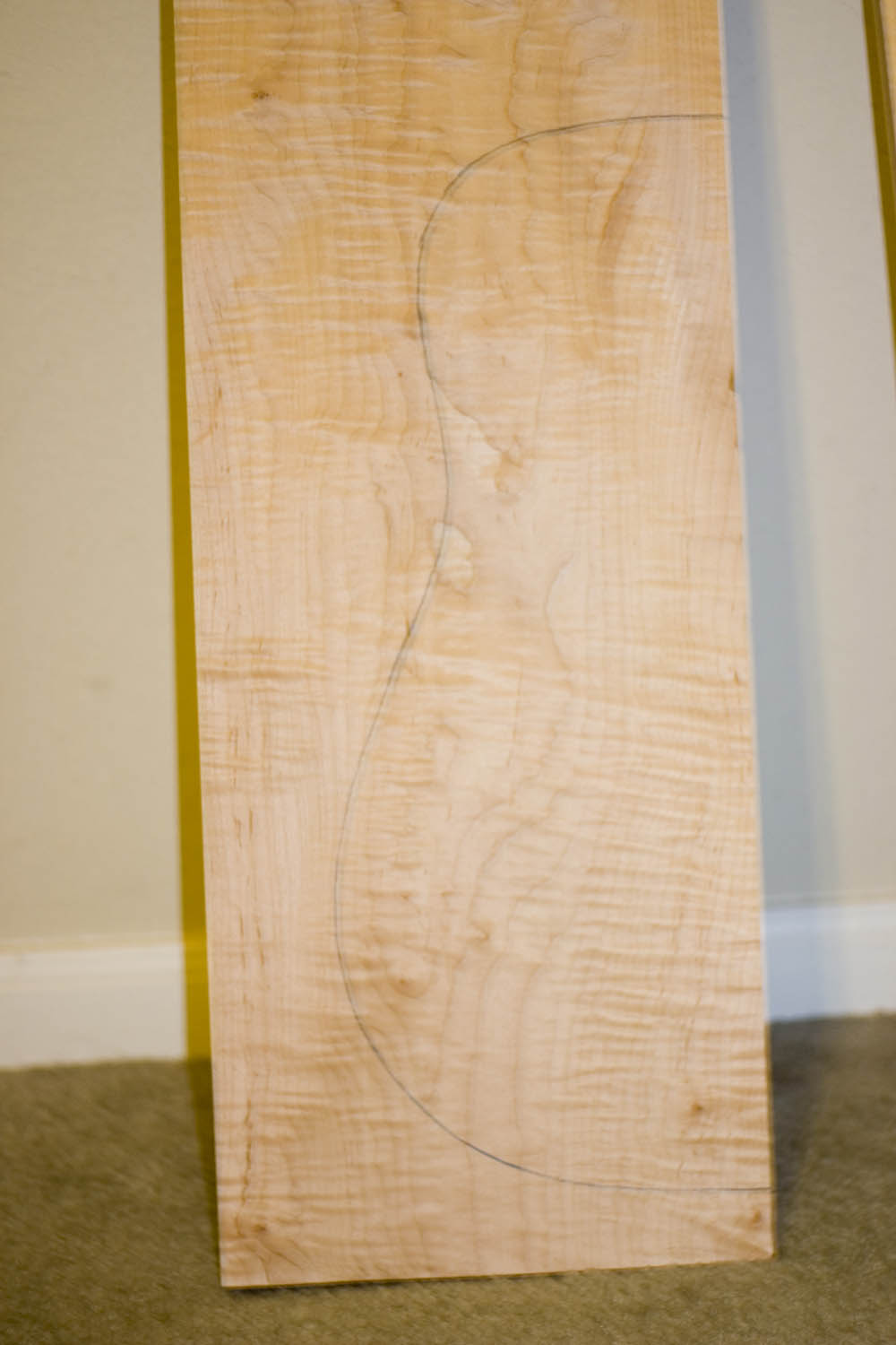

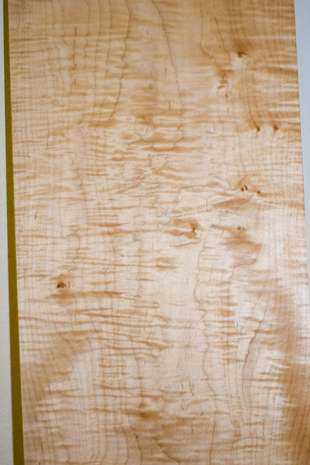

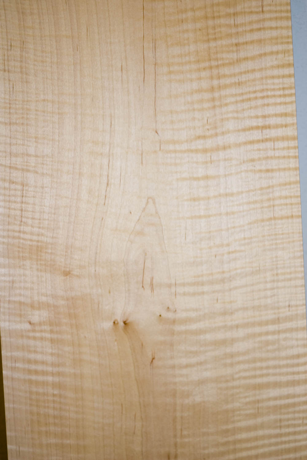

Ok, I just got the wood today and took some pictures.
Please let me know what you think.
Worth it, not worth it.
Wouldn't use for back and sides or ok to use for back and sides.
I've never see curly maple other than already made into a guitar so I really don't know if this is good stuff or not. There's a few spots in the wood that aren't necessarily knots, but some kind of marks, but I think they could all be worked around.
Sorry if these are too big or too small. I'm taking a quick shot at posting these.
Blain
http://www.ullrichguitar.com
PostPosted: Tue Aug 07, 2007 2:38 pm

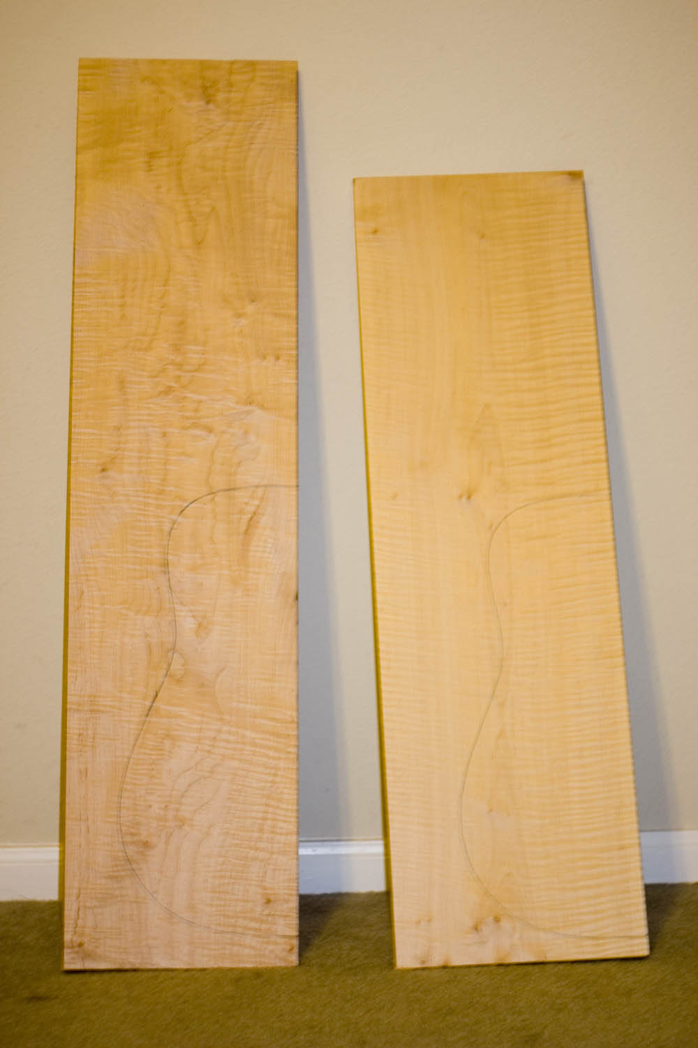

Blain, any chance you can trace the outline of a guitar on one of those pieces somewhere so we can get an idea of their size. Also if you can take a picture of the full piece with the body tracing on it.
They both look like nice wood. Now we just need to see what their size is. I wouldn't hesitate to use them, just depends on what I can work out for the layout.

Rod. Sure, no problem.
I'll try to do this tomorrow if I can. Shoot, I may even find time to do it tonight....
But in the mean time, one is
41.75 X 10.25 X .875+
and the other is
36.75 X 11 X .875+
What you're seeing in these pictures is the width and a segment of the height.
Blain

Ok, it's not that late so I went ahead and traced the pattern on them (in no particular spot so feel free to reccomend one if you see fit).
They're both plenty long to get a set of sides out of as well and the one for sure could yield two different back halves one on top of the other.
I didn't wet these down with water so the figure may not pop a whole lot....
Blain

Wow, sorry for the horrible photos. I obviously didn't take much time taking these.
By the way, these patterns are of a Dread size guitar.
Blain
